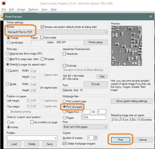

2.If you want the TIFF as a PDF, once again, open the file in an image editor such as IrfanView and print as PDF using Microsoft Print PDF.
TIFF to PDF
Though the final PDF is in grayscale, it might be possible to change each page to a specific color. However, it should print looking substantially as black, even missing cyan. Perhaps the printer has a setting to block magenta and yellow, or they can be removed if in separate cartridges.
