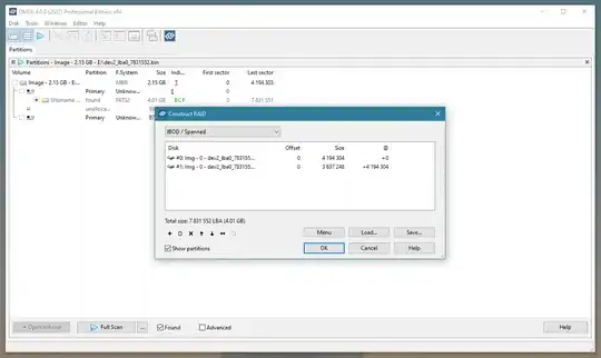

An alternative solution could be DMDE. DMDE allows for even more direct access to the storage device using it's native interface. This allows for greater control over error recovery (compared to dd or even ddrescue).
  1. Create image, use split option
  2. Recover files from the disk image(s)
Split image in multiple parts
To recover files, open the .ini file DMDE created at the time of imaging, it will help re-assemble the image parts as if it were a JBOD array.
Combine image parts as JBOD
If you make image parts one by one, as you seem to be intending, you need to manually create the JBOD array, which would be a matter of adding image parts in the correct order. If you assign meaningful names to the image parts (part-01, part-02 etc.) this should be easy.
Imaging can be done using the free version of DMDE, this version also offers file recovery options: Free Edition includes all features but a single recovery operation recovers up to 4000 files in the current panel only (you should first open a subdirectory in the current panel and then recover files in the panel).
