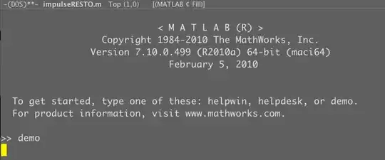

I typed M-! to get the prompt for the shell command, then I typed matlab, and as expected Matlab's command window opened inside emacs, as shown in this figure:
alt text
The problem is that when I try typing commands nothing happens. More specifically, what I type appears there (in the figure you can see that I typed "demo"), but pressing return doesn't behave as expected. Instead of running the command, the prompt simply goes to the next line.

I guess you are using DOS-style line ends but you need Mac style ones. Try to change it using M-x RET p
The MATLAB / Emacs integration project may be a better way to run MATLAB inside Emacs.
Florian Diesch
  • 3,780
  • Florian, M-x is usually followed by the name of the command, not by RET. When I type M-x RET it says "no command name given". Also, Aquamacs is exclusively built for Mac, so I really don't see why it would call anything from Windows (I see that it is written DOS, but this is there even when the matlab command window is not open - maybe it means something else, but I might be wrong). I am using a matlab mode already, which comes with Aquamacs. It might be the same one as the one you mentioned, but I couldn't even download the one above because it requires CVN or something else I dont have... – Vivi Aug 15 '10 at 10:53
  • Sorry, it should be C-x, not M-x. As I don't have neither a Mac nor Matlab I can't check if using DOS line ends really causes this problems but it's something to try. On http://matlab-emacs.sourceforge.net/faq.shtml there's a Matlab script to download the Matlab mode without using CVS if you want to try it. – Florian Diesch Aug 15 '10 at 11:48
  • When I type "C-x RET p" it asks me for the "coding-system for output from the process". What should I put there? – Vivi Aug 15 '10 at 22:40
  • The friend I mentioned above gave me his matlab.el file and the commands to put on my .emacs file, and now it all works. I am not sure, but I think what he gave me is what you also mentioned in your answer. Thanks for your help. – Vivi Aug 16 '10 at 08:49
