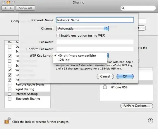

Mac OS X includes a neglected feature called Internet Sharing in the Sharing Preference Pane to do just what you'd like to do.
You can turn this on by going to the Sharing Preference Pane in System Preferences, saying what connection you want to share and to what other device and check off "Internet Sharing". For wireless you can put a WEP (hence my saying neglected before) password on the wireless network. If you're having issues connecting to the internet with the second computer, make sure you have an IP address that doesn't start with 169.254.x.x and the first Mac's firewall will permit connections. I wouldn't recommend this as a long term solution however.
Screenshots to help out:
Preference Pane: Sharing Preference Pane
Airport Options: Airport Options

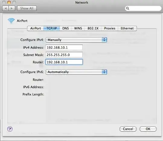

  1. On the computer sharing the connection, give yourself an IP to be reached at.
    You can change this IP to any other private IP if you're familiar with how networks work. 192.168.10.1
  2. On the computer that is connecting, you give yourself another IP.
    Notice this one uses 192.168.10.2 instead. 192.168.10.2

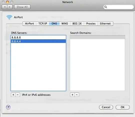

  3. It's important to set the DNS on the second computer as the first computer isn't passing any information on to the second computer as to how the network "looks".
    I'm using Google's DNS Servers here for simplicity's sake but you could put any DNS Server's IPs here. DNS
