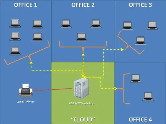

I'd like to be able to send a print command to a local network label printer from a web application running on a cloud server. Say that I want to send a label to my parents house for some reason and the printer is installed on their home network.
I've already asked how to do this via code on Stackoverflow here and on Serverfault related to the networking side here, but sometimes the lines can be blurred from a network admin (serverfault) and a printer like issue (superuser)...
I would like to know if this is possible from a network/hardware standpoint. Are there any "label" printers that I can add to a network? Can I add the label printer as a print device from another network over the web?
alt text

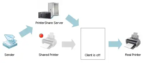

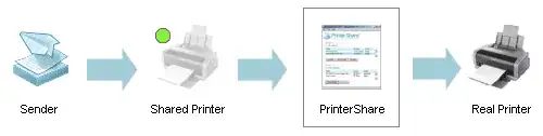

You can use the free product PrinterShare (renamed from PrintAnywhere), available on Windows, Macs and Linux.
The software needs to be installed on the machine you want to print from and on the machine you want to print to. The process is better explained in this makeuseof article.
Here is what the website's How it works says:
If shared printer is online, printed document is uploaded directly to target machine. It is fast and secure. So, normally you want to keep your printers online.
If shared printer is offline, you still can print on it. The document will be temporarily stored on PrinterShare print server, and downloaded by receiving client as soon as it will be ready.
