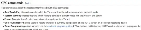

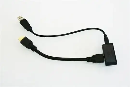

HDMI CEC commands https://www.pulse-eight.com/p/104/usb-hdmi-cec-adapter enter image description here
So this device is a pass-through and only injects CEC commands.
Standby is one of the options, but many other options not listed here exist.
