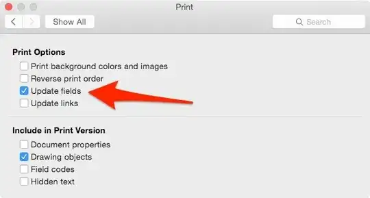

37
Go into the print settings, select update fields. Then go to print, or print preview your doc.
Et voilà, all fields are updated!
MS Word Print Options from Word of Mac 2016
R3uK
  • 352
David Roussel
  • 626
    Working for me now in Word 2010 (where the setting is in“File → Options → Display”). In fact without the option *some* fields are updated but not all. I'm pretty sure it didn't in Word 2007 but I no longer have it to test. – Gilles 'SO- stop being evil' Sep 15 '15 at 14:51
    I'm on Word 2016 for Mac. The setting is in Word -> Preferences -> Print. But on widows it will in the print section of the global settings. I'm sure I've been there in the past, but I don't have an install to test with right now. – David Roussel Sep 15 '15 at 15:55
  • I guess this doesn't work anymore on Word 2016. – TCB13 Jan 07 '16 at 16:34
  • This worked for me in Word 2016 on Windows 7. – bouvierr Sep 27 '16 at 15:33
  • Does not work in Word 2016 Windows. Fields in e.g. footers aren't updated correctly. – Hobbes Apr 14 '18 at 10:15
    Pretending to print works with Word 2010. Not so intuitive… – M. Toya Dec 10 '18 at 09:11
