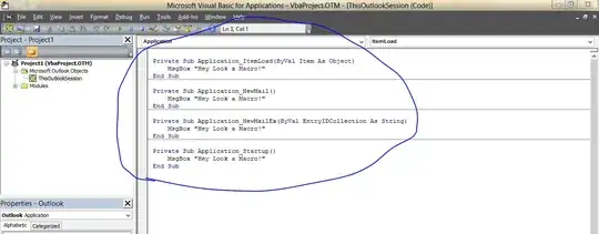

If you're looking to have a macro run based on an event:
This means you're looking to have your code run based on events that happen within outlook. For example, Application_Startup.
Under the Developer IDE (Alt + F11) select Microsoft Outlook Objects -> ThisOutlookSession
Then Select the dropdown that says General and Select Application. You'll then be able to select all the event driven methods that you can add. For Example:
