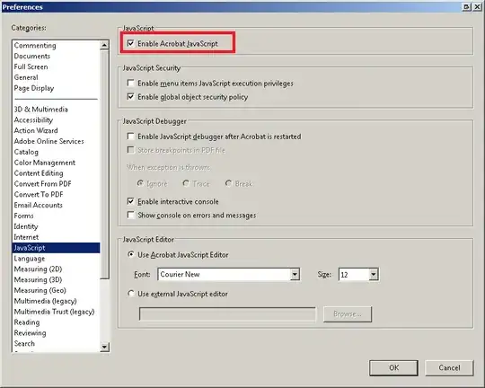

You can use Adobe Acrobat's console JavaScript with the following code, which I took from Dave Merchant's answer on forums.adobe.com:
var cnt=0;
for (var p = 0; p < this.numPages; p++) cnt += getPageNumWords(p);
console.println("There are " + cnt + " words in this file.");
Tested with Adobe Acrobat Pro DC 2018.011.20040 on Windows 7 SP1 x64 Ultimate.
To enable the JavaScript Console:
To launch the JavaScript Console Window:
CTRL + J

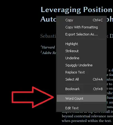

One can use Foxit PDF Reader, select all text, right click on the selected text, then "Word Count":
