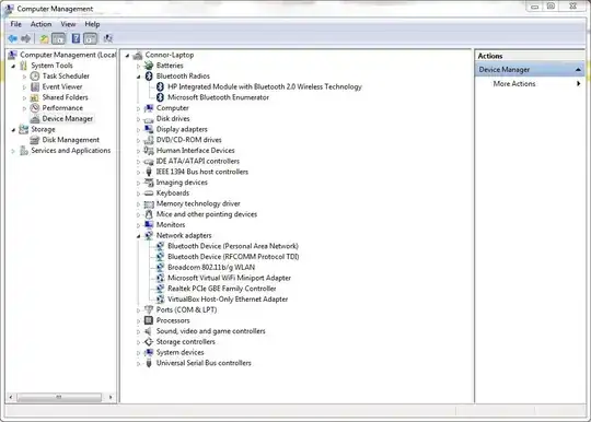

Head into Device Manager and check to see if the bluetooth drivers are installed. I'm guessing you are using Windows 7, so go to the stat menu, right-click 'Computer' and press 'Manage'. This will open the Computer Management window, from here click Device Manager on the left coloumn. There should be a Bluetooth Radios drop down menu.
If that is there and there are no question marks next to the items, it means the bluetooth drivers are installed and it should be working. You should also see some bluetooth items under the Network Adapters drop down.
If you cant see the Bluetooth Radio's drop down, it may be because the drivers arent installed. If that's the case, the radio should be listed somewhere down the list with a question mark next to it. Go to the manufacterurs website and find the drivers for the bluetooth module and that should fix it.
