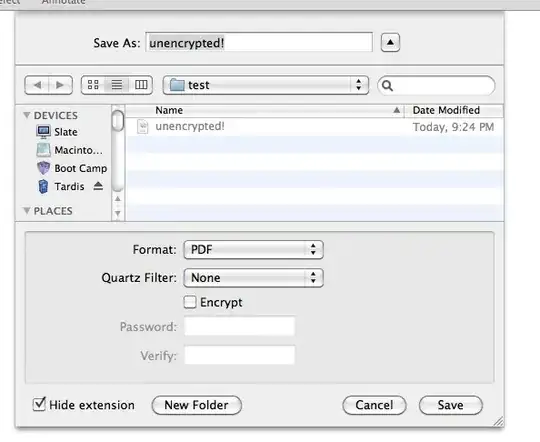

Nathaniel's answer inspired me decide to try File/Save As... in Preview, which let me save a copy of the PDF with no password.
Save As dialog
I'm surprised that it was that straightforward, but it worked.
Brant Bobby
  • 2,466
  • 34
    Doesn't work under 10.9, but then maybe it depends on the type of PDF. DavidThompson's solution worked, both Chrome and Firefox. –  Nov 01 '13 at 23:23
