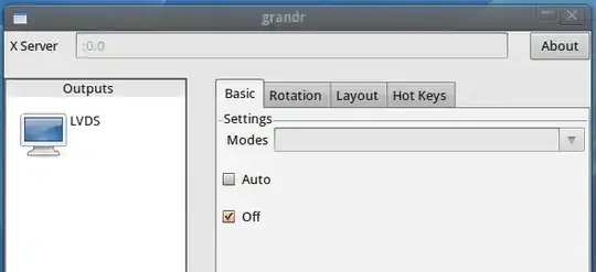

EDIT : I've installed grandr, a GUI for xrandr (in the Ubuntu repositories it's called "Multiple monitors".
But only my laptop screen is in the list. I guess I have to edit the xorg.conf file to add the s-video/tv monitor ?

  • All I managed to do is cloning the laptop screen on the TV. Can I have a different format for the TV ? Even if it means turn the screen off, that'd be ok. – Manu Aug 19 '09 at 12:19
Check what level of support your xserver-xorg- driver has for TV out. For example, check the "TV" section in the ubuntu manual page for the xserver-xorg-video-intel driver. It mentions the availability of integrated TV output and goes on to talk about the tweaks needed to get this working.
See if you can find a similar page for your driver on this site.
