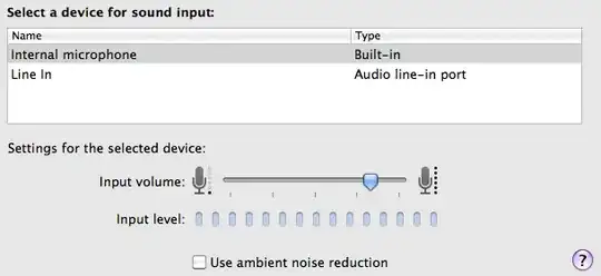

Okay, so eventually I did figure out what was wrong.
Of course, I'm not saying what I got is as good as a decent mic, however I find it much better now, even suitable.
What you'll want to do is go to System Preferences, choose Sound, select Input tab and ensure ambient noise reduction is unchecked for the internal microphone:
System Preferences - Sound - Input - Use ambient noise reduction is unchecked
Apparently, this option is enabled by default and controls a filter that distorts the sound that goes in through the mic. It may be good for noise reduction but in my experience recording is so much better with it turned off.

My advice is to buy a real mic, however there are few settings, you could tweak.
They are located in the Audio MIDI Setup application (nothing to do with MIDI) - format (8kHz-92kHz, 16-32bit) and loudness.
The mic itself is located under the left speaker grille, you could try different recording distances, or disabling sound output from the speakers while recording. Closing or opening display a little could serve as sound reflector.

I notice that when my volume input level is at more than 25%, my instrument gets distorted and blares. maybe try turning your input volume on your mac way down, then play and sing and watch the volume meter to make sure it's bouncing and not just full all the time.

I had the same problem and resolved when I deleted Soundflower.
