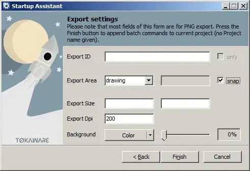

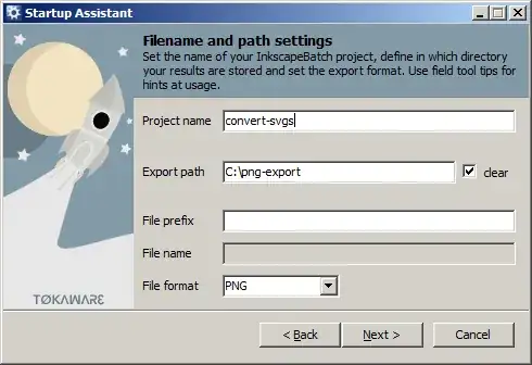

As the resolution for the command line could only be set fixed as far as I could see, I ended up using the InkscapeBatch tool. There I could set the DPI to increase all images relatively.
You need to specify the correct settings or it will not work. Here is what I did:
After you hit "Finish", you need to press the button "Start batch converter..." in the toolbar:
