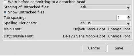

As of git-gui-0.20 and git 2.4.0 (commit) a configuration parameter exists which has been added to configure the displayed tabsize in git gui.
Add this to your ~/.gitconfig
[gui]
    tabsize = 4
or change it via the configuration menu of git-gui (Edit -> Options...)

    Thanks. I updated my Git (was at 1.8 :-O) and I see this option. I still have to deal with a mixmatch of tabs and spaces every now and then so this is great. – Htbaa Feb 11 '16 at 09:45
  • `git config --global gui.tabsize 4` does the configuration job on the command line – koppor Aug 30 '23 at 18:53
