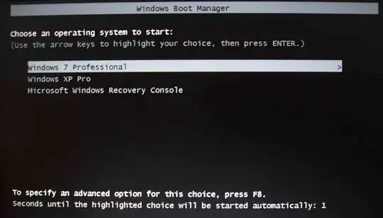

Ok, I already had XP and Windows 7 set up in dual boot with the W7 bootloader, I booted into XP and installed the XP recovery console as shown in your MS link, it installed without error's, I rebooted and when the W7 bootloader showed up, it had the additional recovery console entry, I chose it and it loaded the XP recovery console, it did however give me 2 choices of windows installations to log into, they were identical except for the drive letters.
One thing I did notice was, when I chose to boot into XP from the W7 bootloader, it gave me a choice again to boot into XP or the recovery console, and when I tried to load RC from that menu it failed with a disk read error, but may have something to do with the order I installed the OS's and when I installed RC in XP. I chose D: because I knew it was the XP installation, and the Recovery Console loaded successfully.
EDIT: I managed to get rid of the second RC boot menu, I edited the XP boot.ini file and removed it from there, now when I choose XP from the main W7 boot loader menu, it boots straight into XP, only problem is the RC entry from the main bootloader is now missing. Maybe someone who knows more about dual boot configurations can post a solution, again it may have something to do with my particular dual boot configuration.
EDIT2: I solved the problem of the second RC entry when you select XP from the W7 bootloader menu, is more of a workaround than a fix, boot into XP and go to System Properties > Advanced Tab > Startup and Recovery settings button, set the "time display list of Operating systems" to 0, hit ok,ok, when you reboot you will still have the fully functional W7 boot menu with XP and RC, but now when you select XP, it will boot right into XP without displaying the secondary boot menu showing.
. W7 Bootloader menu enter image description here

  • Do you have any suggestions for avoiding those errors you encountered? I'd like to get this installation as flawless as possible. I previously installed a dual partition of Windows 7 and Ubuntu, but not a triple partition. A little more complicated considering I still want to use the Recovery Console for XP. –  Apr 13 '11 at 18:11
  • Check my EDIT above. – Moab Apr 13 '11 at 18:28
  • You stated, "...only problem is the RC entry from the main bootloader is now missing." I don't considert that a problem at all as it shouldn't be associated with Windows 7. I like the fact that you can only access it by booting Windows XP alone. Would you care to educate me on what exactly you edited in the boot.ini file? Thanks Moab for your insight. It is greatly appreciated. –  Apr 13 '11 at 20:32
  • Its missing and now I cannot load RC from anywhere, thats a problem. I had to restore the boot.ini file to be able to load RC. In other words it breaks it totally. – Moab Apr 13 '11 at 22:21
  • Check my edit 2. – Moab Apr 14 '11 at 16:47
