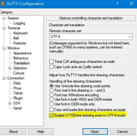

This is now implemented as an option in PuTTY git master.
Putty 0.71 ->
Category -> Window -> Translation -> tick "Enable VT100 line drawing even in UTF-8 mode"
screenshot
