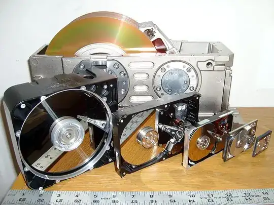

Here's a comparison (8, 5.25, 3.5, 2.5, 1.8 and 1 inch disk):

  • @slhck +1 for picture! – Cajunluke May 10 '11 at 16:46
    +1 for the picture, actually telling me 3.5" harddisk is thicker! So do I get guarantee that the new harddisk buy by my friend will fit into the drive slot? – lamwaiman1988 May 10 '11 at 17:02
    @gunbuster363 If you have a normal desktop PC: Yes, it will fit. those drives have exactly the same size since (almost) ever. – slhck May 10 '11 at 17:04
    Nice picture - that is a big MOFO in the back! – William Hilsum May 10 '11 at 17:11
    @Wil, the 8 inch size was never very popular, I'm surprised to see it show up in a picture like this. You should have seen the 14 inch drives though! Also the 5.25 seems stubbier than I remember. – Mark Ransom May 10 '11 at 17:30

  • Mark, 8 inch drives were very popular. So were [these](https://www.gnz.mpg.de/gnz/pub/museum/A2.jpg). – Simon Richter May 11 '11 at 07:09
  • @Simon Yes, @Wil told me about those just yesterday. 40MB can you believe! – slhck May 11 '11 at 07:34
  • +1 for the OMG factor. This picture brought back some early memories from my childhood :P – Max Kielland Feb 23 '13 at 21:28

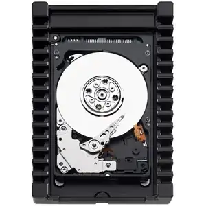

In addition to the 2.5" mobile drives, there are 2.5" "enterprise" drives for heavy file access. See the Seagate Savvio. By having smaller platters, high RPM is more practical, and seeks are physically shorter. Further, more drives can be packed into the same space, which, with a good RAID controller, will give higher performance.
Similarly, the Western Digital VelociRaptor drive uses smaller platters, even though the enclosure is the size of a standard 3.5" HDD, for greater performance, though with limited capacity.

    ...and what appears to be a gigantic heat sink. – Chris Nava May 10 '11 at 16:57
    @Chris Nava - I think the ridiculous fins are also supposed to help dampen vibrations. (They don't help.) – Shinrai May 10 '11 at 17:43
    @Shinrai: IIRC, you can get VelociRaptors without the the heatsink as well, but they are thicker than laptop HDDs (same as `E` enterprise 2.5" HDDs). – paradroid May 10 '11 at 18:02
    They are called `WD VelociRaptor BLFS`- http://www.google.co.uk/webhp?sourceid=chrome-instant&ie=UTF-8&ion=1&nord=1#sclient=psy&hl=en&safe=off&nord=1&site=webhp&source=hp&q=WD%20Velociraptor%20BLFS&aq=&aqi=&aql=&oq=&pbx=1&fp=a19d57c9b1bb4a83&ion=1&fp=a19d57c9b1bb4a83&ion=1 – paradroid May 10 '11 at 18:06
