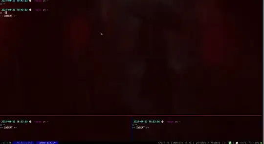

In Bash: Zsh like autocomplete can be achieved with Ble.sh.
# Quick TRIAL without installation
# requires the commands git, make (GNU make), and gawk
git clone --recursive https://github.com/akinomyoga/ble.sh.git
make -C ble.sh
source ble.sh/out/ble.sh
Here is a quick demo of Bash with blesh. For more details see: README of Ble.sh

    May I know the reason why it's unnecessarily downvoted without any explanation? Please help to improve this answer by suggesting an edit instead of downvoting without any insightful and actionable details. – Rakib Fiha Apr 28 '21 at 07:56
    That's exactly what i was searching for! Thanks. – mathway Feb 08 '22 at 22:20
    This is the best answer. Dependencies for `ble.sh` are `gmake` & `gawk`. Prefer `gmake -C ble.sh`, if possible. To install under `~/.local/share/blesh` use `gmake install` (or `make install`) and then add `source /home/ipellegrini/.local/share/blesh/ble.sh` to your `.bashrc` (or `.bash_profile` on MacOS). – Kamafeather Jan 12 '23 at 20:34
  • Love this answer. Works as expected. – rahuljain1311 Jun 28 '23 at 09:24
