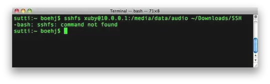

Now I need the sshfs 'plugin' to complete this picture. A typical terminal error message looks as follows:
error
I've tried using MacFusion but that didn't work either. I've also tried the sshfs.app. I believe the problem lies in the 32-bitness of the MacFUSE system.

Well, from the error messages the problem lies in that your shell does not have sshfs in PATH.
You can check your path with:
echo $PATH
and/or you can try to run it with full path like:
/path/to/your/sshfs .. and the rest of the params
Usually on *nix systems you can add to your path (assuming your shell is bash) by editing/creating this .bashrc file to your home directory.
I'm not sure do you have nano editor available, but any editor will do (Word is not and editor).
nano -w ~/.bashrc
add a line to that file
export PATH=$PATH:/path/to/your/sshfs/dir
