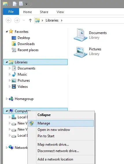

Its a simple fix right click on Computer and go to manage
Now click on storage->disk management you should see your disk as disk 1, now right click on disk 1 and navigate to properties->driver, simply uninstall the driver, remove your hard drive and reconnect.
Problem solved...external hdd will get detected automatically....from my experience it is the driver that gets corrupted, so reinstalling the driver should solve the issue :)
