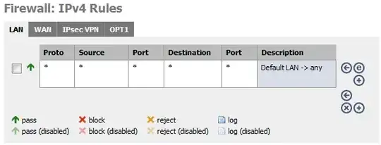

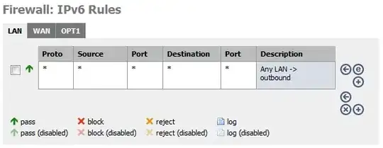

These are IPv6 packets on the LAN interface that are being blocked. Except i allow all traffic on the LAN interface:
And just for good measure i allow all IPv4 traffic on my LAN interface:
