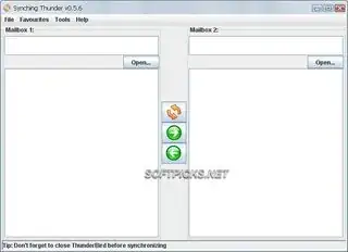

I used to use a program called Synching Thunder and it worked very well. I don't know whether it still is working since it's no longer developed since 2007. If anyone has used it recently and can comment, that would be helpful.
Description
Synching Thunder is designed as an application that synchronizes Mozilla Thunderbird mail between different mailboxes. A typical usage example would be keeping mail on a laptop in synch with mail on a desktop PC.
