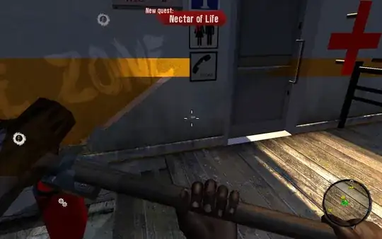

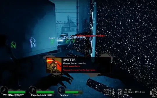

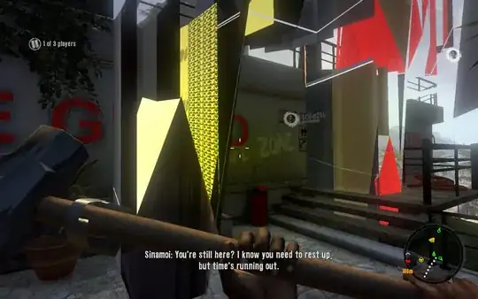

I hope these images aren't excessive, I'd collapse them if I could...
In each one the defects were very active. The first, objects were morphing, smoothly between some weird extremes in odd locations. The second is an example of static that kept getting applied to various objects which was also very active. The third was a stripe that seemd to be mostly static but moved with the camera, and the fourth was very active colorful spikes that would grow/shrink smoothly.
This is just a small selection of things that have happened, from strange shadows attached to the my mouse cursor projected inworld, to straight up screen explosions. I've had this before with dead GPU's but those also suffered heat issues. The hottest this GPU has achieved so far is 80ºC.
I looked into FurMark, but it doesn't really help detect defects. So I'm not sure where to go from here, any help would be greatly appreciated.
Dead Island, Busted Left4Dead Static on specific objects Dead Island, Orange Stripe Dead Island, Colorful (moving) spikes
