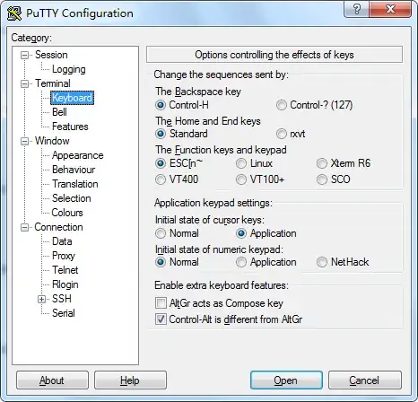

I'm using putty on win7 as client, to log into ssh on a debian server. But I've met a strange problem about keyboard behaviors on putty console.
I noticed that it's about keyboard config in putty. After reading the manual of putty, I successfully made backspace key to work, but still have troubles about ESC, arrows, home and end, and F1-F12 keys.
Here is my keyboard config in putty
Here I list their behaviors below. It seems that the mismapping of ESC is the root cause.
  • ESC => ^[
  • up => ^[OA
  • down => ^[OB
  • right => ^[OC
  • left => ^[OD
  • home => ^[[1~
  • end => ^[[4~
  • F1 => ^[[11~
  • F12 => ^[[24~

The problem is the value of the TERM environment variable does not match the configured terminal characteristics - specifically the "Home and End keys" and "Function keys and keypad" settings.
These can be hard to get right.
What is expected by the Debian server.
Type infocmp -I to see what your computer is expecting.
$ infocmp -I
#       Reconstructed via infocmp from file: /usr/share/terminfo/a/ansi
ansi|ansi/pc-term compatible with color,

What is actually sent by Putty.
To see what Home actually sends, run vi, press i (for insert mode) press Ctrl+V then press Home and press Esc to exit insert mode.
Solution
Adjust Putty config (or TERM) until what is sent matches what the other end expected.
E.g.
Do as specified in https://www.chiark.greenend.org.uk/~sgtatham/putty/wishlist/terminfo.html then in Putty, Configuration, Connection, Data, terminal-type string = PuTTY and save that. Maybe.

There is no mismapping of the ESC key - ^[ means Control-LeftSquareBracket which is ASCII 27 which is ESC
If you suspect the keys to give wrong sequences, check them with od -c and compare them to the infocmp output:
 $ od -c
 (hit F1 Ctrl-D Ctrl-D)
Output may be (033 is ESC):
 0000000 033   [   1   1   ~
Compare it to the output of infocmp (here \E means ESC):
 $ infocmp -1 | grep 'kf1='
    kf1=\E[11~,

Certainly there is a "recipe", but PuTTY's developers chose to not participate in the process. The recipe is referred to as a terminal description. There's been a suitable one in ncurses since 2001 (see link for example to terminal database).
The terminal description is specified to most applications as the TERM environment variable.
Rather than use that "recipe", PuTTY by default sets TERM to xterm, which as you have noticed, does not match the special keys (function, cursor). That's mentioned in the ncurses FAQ Why not just use TERM set to "xterm"?
PuTTY is also mentioned (because of the issue with TERM) in the xterm FAQ, although there is no section devoted to it, because it is not actually an "xterm".
