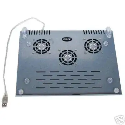

Well, since you asked about other suggestions. (presumably besides his one of changing the hdd to ssd), and I can include pictures of the other suggestions here.
You can get things like this. laptop fan coolers. laptop cooling pads.
barlop
  • 23,380
  • 43
  • 145
  • 225
    I don't think this answers the question. – gronostaj Nov 23 '13 at 17:01
  • @gronostaj well, others have covered the subject and main part of his question but he asked for other suggestions too, so my answer covers that, and it makes more sense for cooling the thing. – barlop Nov 23 '13 at 17:06
  • best coolers IMO are deep cool . I have N8 and N9. The difference is they are solid aluminum with deep grooves. Ever noticed how macbooks are cold to the touch when they are not in use? it's metal. I'd never buy a plastic laptop cooler. – Mikey Jun 16 '16 at 20:55
  • @Mikey The macbook air doesn't even need one of those. It runs quiet and cool. That second cooler pic in my post is metal, it doesn't matter that much, they have fans so they make noise, and they manage to cool it. If it had no fans and cooled a hot laptop then i'd say it was better – barlop Jun 16 '16 at 21:45
  • @Mikey The macbook air doesn't even need one of those. It runs quiet and cool. That second cooler pic in my post is metal, it doesn't matter that much, they have fans so they make noise, and they manage to cool it. If it had no fans and cooled a hot laptop then i'd say it was better Also a friend had a metal laptop that ran very hot, the bottom of the laptop was hot, so it's not necessarily the case that a metal laptop will run cool. – barlop Jun 16 '16 at 21:52
  • @barlop I just meant that macbooks are metal (which is a bad thing because of the "cool"/"hot" thing the metal transfers to you) but, it is an example of how metal is good at cooling.. I think the deepcools are great because of the metal + the side to side deep grooves. The grooves constantly channel the airflow. I agree, there's no reason to use a cooler on a notebook that doesn't need it. – Mikey Jun 16 '16 at 22:08
  • @Mikey I don't think it's bad if a laptop is metal.. i'd rather my laptop was metal and hot, than plastic and keeping the heat in and noisy. And macbooks being metal if it keeps them cooler and not needing a fan is awesome because it helps make it completely noiseless, not subjectively, but objectively, truly noiseless. And if it's truly noiseless then a person looking for a silent laptop doesn't need to rely on subjective reviews about the noise level. – barlop Jun 16 '16 at 22:46
