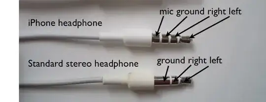

My MacBook Air mid 2012 with OS X 10.8.3 does have the External Audio-IN capability.
It is just bit hidden and not well explained by Big Apple.
As you can read it suggest to use the iPhone headset (with microphone.
Digging in to that one finds out that it is the audio plug (hardware) that is special.
One could be stubborn in wanting to use your microphone and not the iPhone headset version, so this is the solution for that.
A audio splitter from 4 to 3 rings :)
I found stores in Europe (for about €10), but sure you can find it where you are.
