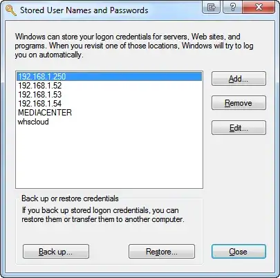

You can open a command prompt: Start > Run > CMD
Type rundll32.exe keymgr.dll, KRShowKeyMgr
From here you can remove authenticated network shares so that the next time you will have to type in the credentials again. I know that this isn't exactly what you're looking for, but may be an alternative.
kobaltz
  • 14,784
    Because I am not clicking on the checkbox to save the credentials, the server does not show up in the Stored User Names and Passwords list. – Logan VanCuren Jan 10 '12 at 04:02
  • This just saved approximately two days of my nerves with clean Windows 7 installation not asking me username/password when trying to connect to already shared (and before re-install accessible) stuff on different computer in the same workgroup. Thank you, good sir. – Smuuf Mar 06 '13 at 02:10
