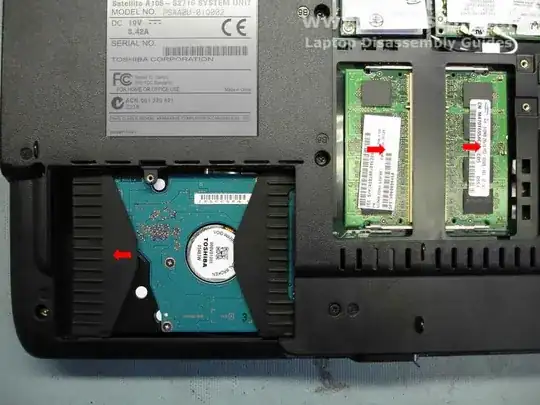

From what I can tell it does not invalidate the warranty to replace the hard drive. However the hard drive you place in the Toshiba will not be covered by their warranty, instead problems with the hard drive will refer you to the manufacturer of the hard drive.
Take a look at these instructions on how to access the hard drive.
  • Locate hard drive compartment:
    alt text
  • Remove cover
    alt text
  • Replace hard drive
