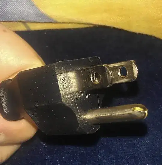

DELL Latitude E6420 that i have got in USA has this plug:

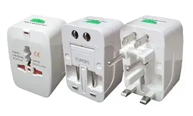

While i have these 2 UK adapters:
Usually neutral and live fit, but ground pin creates here a problem as the plug won't fit into israeli sockets here.
UPDATE: Since i also need traveler's adapter, i think i would better buy one universal adapter instead of power cable so i can kill 2 birds with 1 stone. Unless using traveler's adapter at your home is less recommended than simply buying appropriate cable?

There's a reason the ground pin is positioned there .. exactly to prevent plugging into this type of adapter.
Get an adapter plug which brings out the ground and allows you to connect the ground to the socket in some manner (if you have a 2-pin socket only).

  • Do you know if constantly running laptop on traveler's universal power adapter in my home country is technically safe for laptop? Is it better to buy additional power cable or use traveler's universal adapter? – Boris_yo Feb 08 '12 at 10:37
    @Boris_yo, he is stating that it is needed. It is, without it you are not grounding your chassis, this means a fault inside could charge your case and endanger your life. – Kortuk Feb 11 '12 at 06:35
  • @Kortuk What case? – Boris_yo Feb 12 '12 at 08:59
    @Boris_yo, your computer, probably, has a mostly metal case that forms the outside of your PC. The think you have to open to access the guts of your computer. This forms shielding for your PC to outside interference and forms shielding for the outside world from your internal components generating interference. – Kortuk Feb 12 '12 at 23:59
  • @Kortuk I have laptop, not desktop. – Boris_yo Feb 13 '12 at 23:04
  • @Boris_yo, i missunderstood an earlier comment from you, it still has an internal metal structure for emissions, almost all do. – Kortuk Feb 14 '12 at 01:10
  • Universal adapter does not have grounding. It has fault protection so if something goes wrong, it is adapter that will take the hit. – Boris_yo Feb 14 '12 at 08:47
