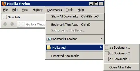

Initially, my solution was to assign a keyword to a bookmarklet and then use AutoHotkey to automate the following steps: pressing Ctrl+L to select the address bar, typing in the keyword, and pressing Enter.
This works great with normal bookmarks, as you will be taken to a new page. However, with bookmarklets that work with the current page, this is clumsy and moves the keyboard's focus. So, in an effort to avoid the address bar altogether, I've devised the following solution.
Setup:
  1. Create a new folder in the Bookmarks Menu. Since we will be using the keyboard, give it a name that can be accessed with one keystroke, i.e. the first character is unique. I chose .Hotkeyed.
  2. Move your bookmark to this folder, renaming them to begin with a character. This character will be used as part of the hotkey. For example, a : Bookmark.
  3. Now, let's be sure we can click the bookmark using the keyboard. Pressing Alt, B, . should nagivate like so:
    bookmark menu
    and pressing a should click the first bookmark.
AutoHotkey Script:
Why press four keys, when you do it in less?
#a:: ;Win+A
KeyWait, LWin ; Win+Alt alone does nothing.
Send, {Alt} ;Menu >
Send, b ;Bookmarks >
Send, . ;.Hotkeyed >
Send, a ;Bookmark 1
Exit

  • Thanks for your reply. This works but it changes the contents of the address bar. Can you find a way to restore the address bar to its original contents? – jdigital Feb 09 '12 at 19:04
  • @jdigital Sure! I will update the script. – iglvzx Feb 09 '12 at 19:06
  • Hold on... I have a better idea which avoids the address bar altogether. – iglvzx Feb 09 '12 at 19:23
  • @jdigital Updated. Let me know if this works for you. :) – iglvzx Feb 09 '12 at 20:00
    Great idea: placing the bookmarklet in a menu location that is accessible by single letter navigation. The `IfWinActive` code doesn't work for me, but you've provided enough information here to allow me to solve the problem. Thank you! – jdigital Feb 09 '12 at 20:53
    @jdigital Ah. I sometimes have problems with `#IfWinActive`, too. I'll remove it, since it is not strictly necessary. You're welcome! – iglvzx Feb 09 '12 at 21:03
  • Is the `KeyWait` really needed? – jdigital Feb 09 '12 at 21:22
  • [Win] may interfere with [Alt], so I use it as a precaution. You can try with and without `Keywait` to see if it makes a difference for you. – iglvzx Feb 09 '12 at 21:28
  • Works for me without KeyWait. BTW, I think the problem with `#IfWinActive` is the `SetTitleMatchMode`. If I use the `IfWinActive ahk ...` then it seems to work. – jdigital Feb 09 '12 at 22:40
  • @jdigital Thanks for the tip! I will read up on the documentation and play around with it. – iglvzx Feb 09 '12 at 23:08
