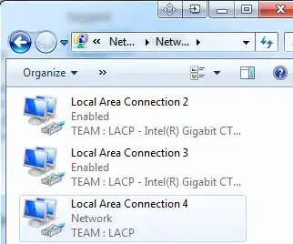

The first computer is a Windows 7 machine that has the Intel ANS software installed. I have LACP configured with the computer and now show 3 NICs (2 Physical + 1 TEAM Virtual @ 2Gbps). It looks like this computer is configured correctly. I trunked the two ports that this computer is plugged into with the switch's web interface.

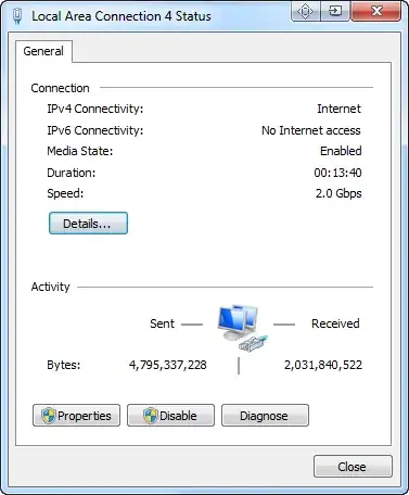

With LACP enabled on both machines I am getting about 106-108MBps speeds.

[Edit] - Corrected some numbers, wasn't really paying attention. It looks like the speeds though at least two NICs are bonded with LACP is still reaching the max bandwidth of one port. Is there a way to configure the switch so that I can increase this bandwidth? Also, on the storage server, I had a couple of extra NICs laying around and threw them on there as well.
Another EDIT and More Findings
I happened to look at the traffic of each individual NIC and think that I see the problem. I tested with a simple transfer for a 4GB file. I noticed that only one of the NICs was taking the load of the traffic. I then copied the file back to the Storage Server and noticed that the other NIC was sending out the traffic. I have 802.3ad LACP enabled on the two NICs and I see that it gets enabled dynamically on the switch's interface. Should I be using Static Link Aggregation?
