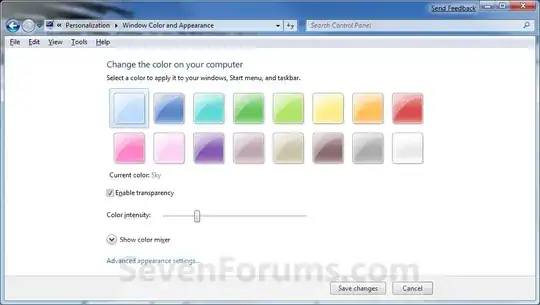

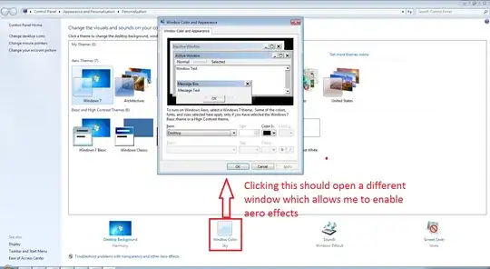

I can't enable Aero effects on Windows 7 Enterprise edition. I'm at a loss of how to enable it. Thanks for the help! Let me know whether I could include anything else which would be helpful! Here are a few helpful screenshots...
This is where you should normally enable this feature This is where you should normally enable this feature
Here's what that window should look like enter image description here
This is just another example of me not being able to do anything with this This is just another example of me not being able to do anything with this
Here's the real error Here's the real error
The driver I have here is for remote desktop. I'm not using this remotely, but on my laptop. the driver

    Not to be snarky, but I think you should check your eyesight - it looks like the mirror driver *is* there. 'LANDesk Remote Control Mirror Driver'. Are you connected remotely to this system? That mirror driver shouldn't be used unless you are, so this should be working. – Shinrai Apr 30 '12 at 17:21
  • Ah! I'm embarrassed! Yeah, there it is. I'm not connected remotely to this system, it's my lenovo t420 thinkpad laptop. – kentcdodds Apr 30 '12 at 17:23
  • I updated my post to reflect my bad eyesight. Haha. – kentcdodds Apr 30 '12 at 17:28
  • Well, for whatever reason, it thinks it's rendering with that mirror driver. It's possible that simply having it installed is enough to disable Aero. You could disable it in Device Manager (or uninstall the remote software) as a test. – Shinrai Apr 30 '12 at 17:30
  • That worked! If you want to submit an answer I'll accept it to give you the points. Thanks :) – kentcdodds Apr 30 '12 at 17:33
  • as requested. ;) – Shinrai Apr 30 '12 at 17:46
