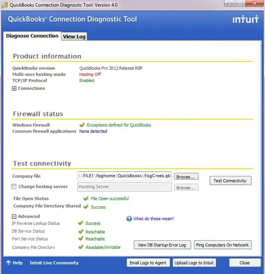

I was able to open quickbooks just fine, but when I try to switch to multi-user mode, it gives me error H202.
  • Quickbooks Database Server Manager is running correctly on the file server.
  • The Quickbooks Connection Diagnostic Tool reports no errors and opens the file just fine.
  • I'm using Quickbooks 2012 (oddly, this never happened under Quickbooks 2010)
qb diagnostic tool output
