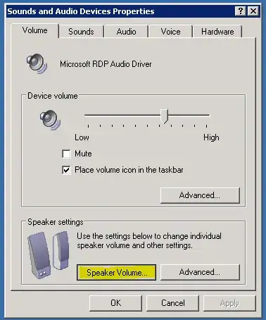

Have you tried setting the speaker volume? Can also set the type of speaker to headphones by clicking on the Advanced button beside the one for Speaker Volume.
Sounds and Audio Devices Properties, Volume, Speaker Volume. (Right click speaker icon on task bar) and select it.

  • Already tried. All sliders (speaker volume, device volume and master volume) are linked and move simultaneously when I drag one. Setting desktop speakers or headphones doesn't change anything. – Mark Jeronimus Jun 04 '12 at 03:06
