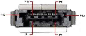

How to check if my eSATAp port provides 12V power?
To know if your eSATAp can supply 12v or no, check the existence of P12 and P13 pins inside the port as it showing in the pictures.
Also you can probe P12 and P13 using DMM(Digital multimeter)
This link provides more detailed information about eSATAp.

  • Thank you! Unfortunately, my laptop doesn't have P12 & P13. (But the port looks more like eSATAp over the "eSATAp on notebook") – djmati11 Jun 12 '12 at 14:30
