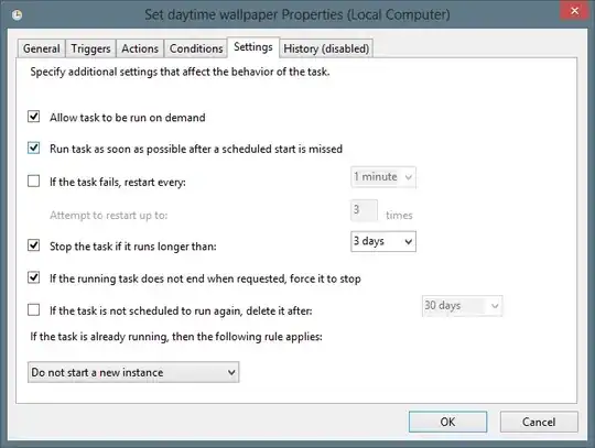

Use the task scheduler and create a VBscript to change the wallpaper. Create a script for each wallpaper you intend to use.
dim shell
Set shell = WScript.CreateObject("WScript.Shell")
wallpaper = "C:\path\to\wallpaper.jpg"
shell.RegWrite "HKCU\Control Panel\Desktop\Wallpaper", wallpaper
shell.Run "%windir%\System32\RUNDLL32.EXE user32.dll,UpdatePerUserSystemParameters", 1, True
Save the file as something.vbs and add it to the task scheduler, and voila! You got it all working.
It was also mentioned that it wouldn't change wallpaper if you've had your computer shut down at the time it should change. This is wrong, as the task can be set to run on the first boot after the selected time, so it will be set once you start the computer even if it was off during the time it should have changed. To set this up, go to the specific tasks properties and into the settings tab. Tick the second box in the window and off you go.
This script works perfectly for me in Windows 8. Please note how I modified the original script a bit to make the script shorter.
