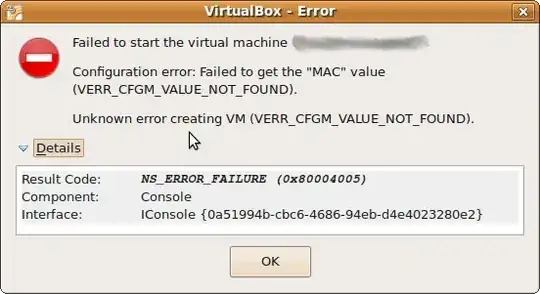

I have an Ubuntu 9.04 desktop 64-bit guest OS running on an Ubuntu 9.04 desktop 64-bit host OS (yes, the same OS). I'd like to run a web server on the guest and make it accessible through NAT on the host.
I (think I) followed the VirtualBox port forwarding instructions, but the guest/VM won't start after I do the configuration.
Here's the configuration that I ran:
VBoxManage setextradata "<Guest Name>" "VBoxInternal/Devices/pcnet/0/LUN#0/Config/guesthttp/Protocol" TCP
VBoxManage setextradata "<Guest Name>" "VBoxInternal/Devices/pcnet/0/LUN#0/Config/guesthttp/GuestPort" 80
VBoxManage setextradata "<Guest Name>" "VBoxInternal/Devices/pcnet/0/LUN#0/Config/guesthttp/HostPort" 8080
Where <Guest Name> is the name of the guest VM image.
The error looks like this:
The same error happens regardless of whether I run the configuration while the VM is running, or not running.
Guest additions are installed.
How do I properly configure the NAT port forwarding? What is causing this error?

  • Are you sure your virtual network adapter is PCNet? When I create a virtual machine and choose ubuntu x64, i get e1000 by default. – Bender Oct 01 '09 at 13:57

I had the same symptom when I setup up port forwarding in VirtualBox.
When I create new VMs in VirtualBox, the default network adapter is e1000, not pcnet as per the instructions you followed.
If you modify the config settings to:
VBoxManage setextradata "<Guest Name>" "VBoxInternal/Devices/e1000/0/LUN#0/Config/guesthttp/Protocol" TCP
VBoxManage setextradata "<Guest Name>" "VBoxInternal/Devices/e1000/0/LUN#0/Config/guesthttp/GuestPort" 80
VBoxManage setextradata "<Guest Name>" "VBoxInternal/Devices/e1000/0/LUN#0/Config/guesthttp/HostPort" 8080
This should solve your problem.
The above configuration option will work for the first e1000 adapter, hence the e1000/0 in the settings. Double check which network adapter is being used by the VM you are trying to port forward to.
On my installation, the network adapters available are two "PcNet" ones and three "Intel Pro 1000".
