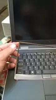

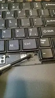

Out of frustration I did a little surgery on the keyboard and unhooked the 4 conductor ribbon from where it feeds the point stick on the bottom of the keyboard. See youtube for keyboard removal videos. After the two screws on the bottom (located in the square holes on either side of the docking station jack) are removed (they MUST be removed), pry off the plastic trim ring around the keyboard.
Lifting out the keyboard border ring

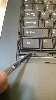

Besides the two screws on the back in the inset square holes, There are 4 small screws that come out next, that hold the black tabs of the keyboard at the edge near the from edge of the computer.

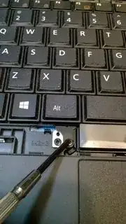

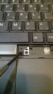

1st of 4 screws to remove 2nd screw to remove
3rd screw 4th and final screw
The keyboard should now lift out if the 2 screws are removed from the back of the computer.

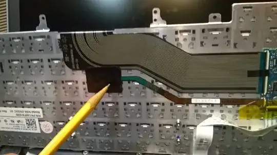

Now lift out from the near edge and carefully disengage the multi-ribbon from the laptop chassis. If you don't know how to do this then don't. You will ruin it. Once the keyboard is loose turn it over. You will see a small 4 conductor ribbon going to the bottom of the keyboard where the point stick is located.
point stick from under the keyboard

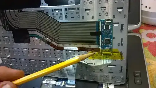

Follow the ribbon back to the small circuit board on the bottom of the keyboard where the bigger multi-ribbon also attaches.
The point where the surgery takes place. Tape is already removed.
Lift the black tape covering the connection of the 4 conductor ribbon cable and carefully open the connector to remove the ribbon. Close the connector and lay the ribbon on top. The point stick is now dead. Place the tape back over everything and reassemble the keyboard to the computer. Surgery complete. Time to close it up doctor.
I just finished doing this to the E6420 that I am typing this on. Nothing else worked. No more annoying point stick.
