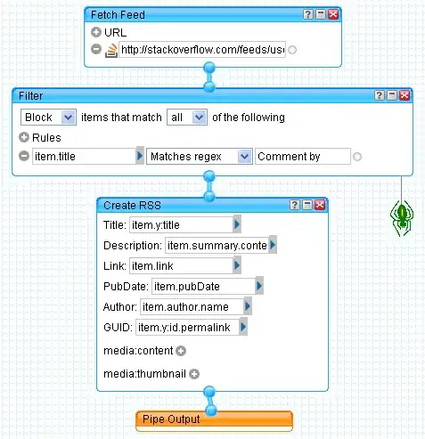

For some reason when you build up the custom filtered feed, Yahoo! Pipes doesn't really handle the summary all that well off the bat.
What you'll need to do is bring it back in with the Create RSS module from the Library.

Create RSS (Operators)
Flowing on from the previous, the Create RSS module is where you'll be rebuilding the actual RSS so that the summary comes through. This has to do with the feed having been filtered and now just needing to be put back together with all the parts that made it to the other side of the filter.
Title:[item.y.title]
Description:[item.summary.content]
Link:[item.link]
PubDate:[item.pubDate]
Author: [item.author.name]
GUID: [item.y.id.permalink]
The above fields on the right side are taken from the feed itself.
Finally, run the last wire to the Pipe Output.
In the end you should have something like this in the Pipes Editor Canvas:
Pipes layout
Then save, Run Pipe and grab the newly recreated RSS feed.
