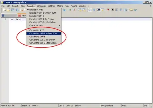

I'm using Notepad++ for editing my PHP scripts.
However, I found a strange problem: when changing the encoding from ANSI to UTF-8 (without BOM), saving, closing, re-loading – then checking encoding: is still ANSI.
Any ideas what's wrong? It always worked for me in the past.

You have to Convert to ... instead of change the Encode to ... option.
You may also want to change this option in the settings, so all your new files will get created with your choosen encoding.

    thanks for your comment, already did that but didn't help. when selecting "convert to ..", saving, reloading - it's still ANSI. i also tried creating a new file and pasting. – Fuxi Jul 12 '12 at 11:49
