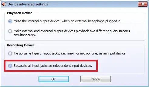

I was able to fix the internal microphone in Realtek HD Audio Manager:
  1. Open Control Panel → Hardware and Sound → Realtek HD Audio Manager.
    Control Panel
  2. In Realtek Audio Manager, select "Device advanced settings" in the top right.
  3. Select "Separate all input jacks as independent devices" and click OK.
    (If you don't see an option to separate jacks, you may need to update your Realtek Audio drivers.)

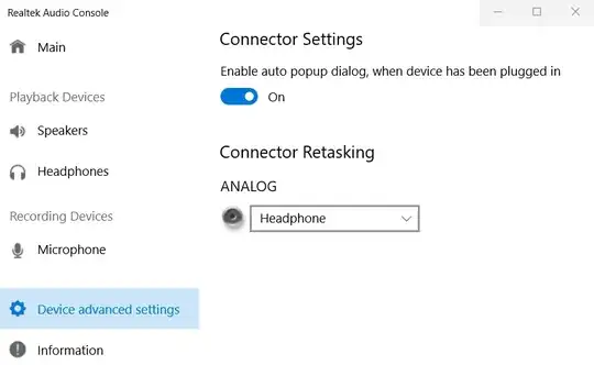

I would like to add an answer since I was having the same issue. I'm using an Asus VivoBook with Windows 11, and whenever I plugged earphones or headphones into my computer, the computer's microphone stopped working - even if my earphones had no microphone!
Once my headphones or earphones are plugged in, there is a window that pops up for the Realtek Audio Console app. If this doesn't pop up for you, you can just search for it and open it (it came pre-installed on my computer). Then, navigate to the "Device Advanced Settings" tab. Under "Connector Retasking", you have the option of selecting whether you just plugged in a Headphone, a Headset, "Mic In", or "Speaker Out". For me, the default setting was "Headset", which meant that the computer thought my device would have its own microphone. If you switch it to "Headphone", then the computer goes back to using its own microphone.
