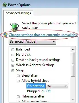

I do not have any 3rd party software installed to manage the UPS, I am using default Windows battery handling. My advanced power settings when on battery are as follows:
  • Sleep after: 20 Minutes
  • Critical battery action: Sleep
  • Low battery level: 20%
  • Critical battery level: 10%
  • Low battery notification: On
  • Low battery action: Do nothing
  • Reserve battery level: 7%

The computer detects a critical action (no more power going into the UPS causes use of the battery, a critical action) and the computer sleeps to conserve power. Please post a picture of the output of the screen below, but open the dropdown that says Sleep>+Sleep after.
