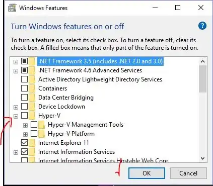

I tried all of the above mentioned answers, none of them worked.
So I found out the Hyper-V in windows 7 and higher (in my case it is windows 10) is the culprit!
I disabled the Hyper-V services as below and the issue is fixed!
Follow the following steps:
  1. Find the "Turn windows features on or off" from control panel (or type windows features in windows search box)
  2. Uncheck the "Hyper-V" feature from the list
turn Windows features on or off window screenshot

    +1. Works for me on Windows 10 (winver 1607) and VirtualBox 5.1.26 – honzakuzel1989 Sep 07 '17 at 05:50
    +1, this saved my life on Windows 10. I am running Docker (that uses Hyper-V) and Oracle VM VirtualBox and they don't fit together well. Is there anywhere we could report this as an issue so that future generations wouldn't have to suffer this pain? – eddyP23 Sep 27 '17 at 09:12
    This solution fixed my VirtualBox 5.2 on Windows 10. Thanks – Strabek Dec 11 '17 at 14:23
  • I have the same problem with VBox causing an occasional BSOD, but in my case the Hyper-V is NOT installed (already unchecked in the list of features, like suggested here). So, I don't know what I am supposed to do, in light of the fact that I cannot work without the VBox for the docker machine I need for the current local project run... – TheCuBeMan Sep 05 '18 at 12:01
