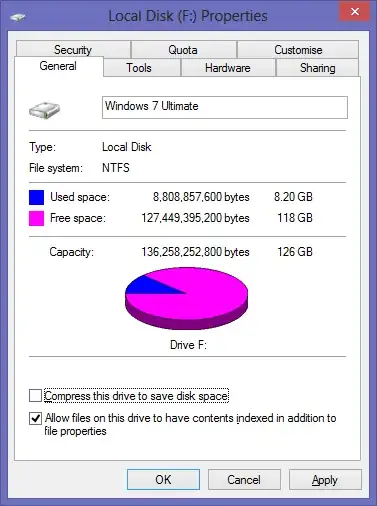

The VHD's were mounted as read-only into my main OS, and the properties for each were brought up.
Windows 7 Ultimate SP1:
Windows 8 Enterprise:
The Conclusion
Windows 8 Enterprise takes 3.38% more space than Windows 7 Ultimate SP-1.

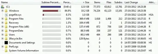

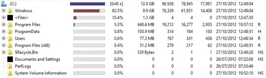

WinDirStat from the host computer onto the mounted VHD's gives the following output (drive F is Windows 7, H is Windows 8):
WinDirStat run on the Windows 7 VM gives:
WinDirStat run on the Windows 8 VM gives:

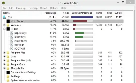

I took the plunge and installed Windows 8. Before installing Windows 8, I installed Windows 7 for a controlled comparison. Quick answer: both Windows 7 and 8 consume similar disk space, a little over 17 GB.
The exact answer depends on how Windows 7 and 8 compute file/disk sizes. Windows 8 simultaneously consumes less space and leaves less free space than Windows 7. In addition, Windows 8 reports a total disk size that is nearly a gigabyte smaller (on the exact same hardware) Percentage-wise, all the numbers are almost exactly the same:
           GB used       GB free       GB total
Windows 8  17.3 (27.9%)  44.8 (72.1%)  62.1 (100%)
Windows 7  17.6 (27.9%)  45.4 (72.1%)  63.0 (100%)
Methodology:
  • Both installations were done on the exact same hardware, preceded by a clean format of the entire drive
  • Windows 8 version: Windows 8 Pro 64-bit
  • Windows 7 version: Windows 7 Ultimate with SP 1 64-bit
  • Interestingly, Windows 7's required system reserved partition is 100 MB while Windows 8's is 350 MB
  • Used/free space numbers taken from WinDirStat
Windows 8 results: enter image description here
Windows 7 results: enter image description here
