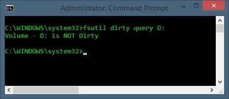

If you have not asked for a chkdsk to be carried out, the autocheck will be carried out if the disk's "dirty bit" is set. This will be set if Windows is not shut down correctly, file changes have not completed or the disk is corrupted. It may indicate the disk is about to fail. For an external disk, it may indicate it was removed without using the 'safely remove hardware' function.
The fsutil command can be used to check the status of the dirty bit. Open a command prompt with admin rights and type:
fsutil dirty query D:
(Replace D: with the letter of the drive you are having issues with.)

    I check my hard disk, it is dirty - what should I do to correct this? – khris Sep 03 '12 at 14:03
    Try running `chkdsk /f e:` or `chkdsk /f /r e:` manually. If the dirty bit is still set after the next reboot, the system probably cannot umount the volume on shutdown. Check the `eventlog` for pointers if that's the case – Ansgar Wiechers Sep 03 '12 at 14:27

  1. Click on your start menu and open the run dialog.
  2. Type cmd and return
  3. Next type fsutil dirty query D: (replace D: with your drive letter)
fsutil dirty query
If the return message indicates that the volume is dirty then continue with these steps:
  1. Next type chkdsk D: /f /x
  2. After that finshes repeat step 3 to determine if dirty bit has been removed.
  3. If it is no longer dirty then reboot and you should notice no more chkdisk.
Source of Information
