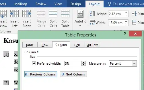

No need to change the XSL file. Click on the bibliography and the table menu appears. Open the table properties and navigate to column. There you can click on Previous Column or Next Column. I had to click on Previous Column twice to get the column where the numbers are. Now you can change the percentage of the column width. I had to choose 3%.
Screenshot
I'm using Word 2016.
Edit: Maybe you have to choose Distribute Columns before and then choose the right percentage
