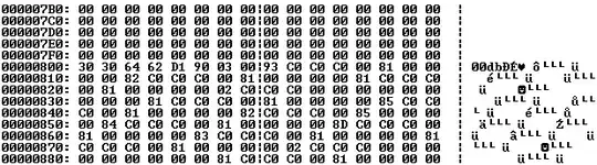

On the flip side as well, CamStudio doesn't write an AVI header into its temporary file. So the only available information for me is that the video was encoded with the Lossless RGBA Compression codec, which I think is identical to Huffyuv. I would like to have an application which can recognize Huffyuv data patterns and extract them from stored blocks. I guess there is a distinct data pattern of Huffyuv, moreover I found a constant byte sequence with which a Huffyuv stream generally seems to start. Here you can see it in HEX and ASCII format ("00db" in ASCII):
I know the width and height of the video, also the color depth. There must be a data recovery tool or method which could help in my situation. The question is, who knows any?
