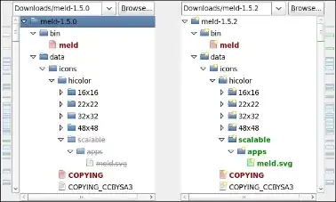

Have you tried meld? I have no idea if it's any good for huge trees, but you can always give it a try :)
Meld is a visual diff and merge tool targeted at developers. Meld helps you compare files, directories, and version controlled projects. It provides two- and three-way comparison of both files and directories, and has support for many popular version control systems.
Meld helps you review code changes and understand patches. It might even help you to figure out what is going on in that merge you keep avoiding.
Peltier
  • 6,094
  • 62
  • That's a very good and nice diff tool, but cannot save a directory tree state (at least not in the version I have) for later use and comparison – jdehaan Sep 30 '09 at 13:46
