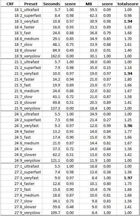

I did a test in which I trans-coded (using libx264 encoding to .mp4) a high quality video from a Sony camcorder using the full range of preset values (except placebo) on a range of CRF values (18, 21, 24, and 27). I wanted to know what would give me the best combination of encoding speed, output quality and file size.
For each CRF value, I gave each trans-code operation a score for its encode time (e.g., for CRF = 18, preset value ultrafast's time of 5.7 seconds got a score of 1.0, veryslow's time of 162 seconds got a 0, with all other scores scaled in between). I calculated output file size scores similarly, of course giving the smallest file the best score. I then added the two scores for a "combined" speed/size score.
For each of the four CRF values, the "veryfast" preset was the hands-down winner, with nearly perfect scores of 1.94 (for CRF 18 and 21), 1.96 (CRF 24) and 1.97 (CRF 27). I find it very curious that "veryfast" produced nearly the smallest file size every time, losing only to "veryslow" and never by much.
One difference I did notice among the various preset values was that the operating system (Windows 7) would give me different thumbnails. The faster presets would show a thumbnail several seconds into the video, where the thumbnails for the slower presets would reflect the opening frame(s) of the video. That's not important for me; what I learned was that "-preset veryfast" seems to be an easy choice.
Here are my results (as a snapshot image of an Excel spreadsheet):
excel snapshot

jakar
  • 153
Ted W
  • 461
    I know Super User’s formatting options are mediocre, but it might be helpful if you posted the data as text — possibly using code formatting. – Scott - Слава Україні Oct 14 '17 at 19:37
    Fascinating. It is also faster on my machine. Thanks! – joeytwiddle Oct 14 '18 at 11:11
    I must admit that I looked on your results with suspicion, but I've repeated the test and got v. similar results, using ffmpeg version 3.3.2-1 on a 2 min 1080p movie clip. In fact veryfast generated the smallest file size 60% of the time, and coming 2nd to veryslow 40% of the time (but not by much). From now on I'll be using veryfast for all my encodes along with a fairly low CRF value (18, 19, 20) since veryfast was only a little slower with the lower CRF values than it was with the higher ones. Thanks you've saved me lots of time. Raw data and script in comment below. – mattst Nov 09 '18 at 17:22
    Continuing from the comment above... Here's my [raw data - CRFs 18 to 27](https://gist.github.com/mattst/2a0ff8de12e0fedb2ad72ccf7131bf71) and the Linux/UNIX [bash script](https://gist.github.com/mattst/9ffee93f5053ba59275af800f0dbd654) that I wrote to run the encodes (in case anyone wishes to run a similar test). – mattst Nov 09 '18 at 17:25
    Here are some great blog posts on the subjects, with tests conducted for [x264](https://write.corbpie.com/ffmpeg-preset-comparison-x264-2019-encode-speed-and-file-size/) and [x265](https://write.corbpie.com/ffmpeg-preset-comparison-x265-2019-encode-speed-and-file-size/) (results are, predictably, very different for each) – forresthopkinsa Feb 20 '19 at 06:46
